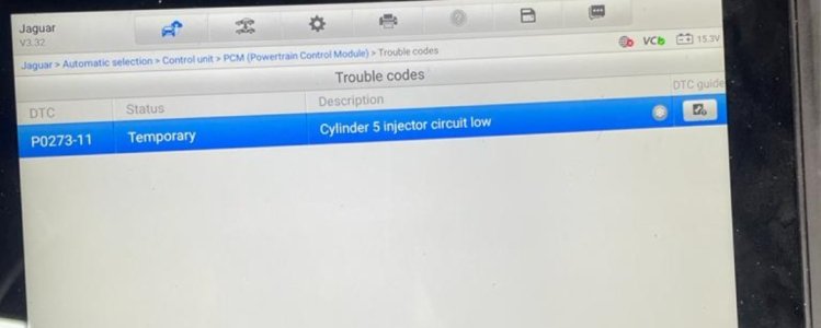

All, last weekend whilst parking I had the dreaded rough idle and limped a mile home on what seemed like 5 cylinders.
I called my trusty independent mechanic to pop over and have a look, error code in pic. We went ahead and changed what we thought was injector number 5, but actually turned about to be incorrect. I have attached a diagram below (based on my reading online).
He then went ahead to remove injector 5 and unfortunately... snap. Whilst he was extremely careful we ended up with an injector in 2 pieces. It seemed to be corroded in but he had a trusted trick up his sleeve. He poured in some coke and left it overnight and after persistenting an hour this morning he cleanly removed and replaced the injector.
I decided to get the injector from Jag and probably massively overpaid but didnt want to risk a part issue. Seems like the Bosch part number is
0261500297 but cant seem to find a reputable retailer of the part... just have to look at it as OEM tax!
I am glad to say injectors all in, some BG44k in the fuel and the cat is running better than ever :)
