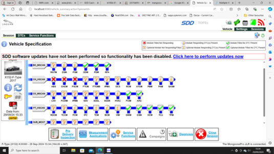

A second-hand unit was sourced and fitted. The car started once and now will not. The steering wheel lock will not release anymore.
We bought a copy of SDD and scanned the car attached, however, the ABS module is not communicating. I have checked every fuse on the car and the wires to the ABS pump have power.

My current thoughts on fault are:
1. Replacement ABS pump was faulty, although we now have another which is just the same
2. Fault on CAN? Not really sure how to test
3. Copy SDD not capable of working on this car? I know 2017 is kind of a cut off
4. Other fault unrelated?
Any thought, proposals would be appreciated. Petrol and a match have been getting a tempting option.

SDD won’t work and you would need Pathfinder…which has ceased to be as the servers have been switched off, so you now need Topix Online to do anything
