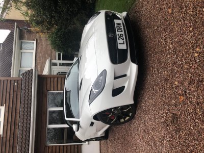

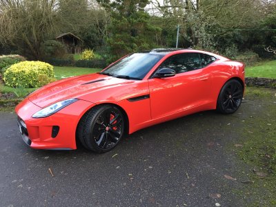

Hi all. New to the forum and new to F Type ownership. Absolutely loving it. I have my Son to blame as he bought a white 2015 convertible and that was enough for SWMBO and me to get our 2016 S. Here is the boy's and ours:
Our Son has had his Polaris a couple of months now, we had ours last week. The plate off his white one is now showing on a Pug 208, talk about a change!

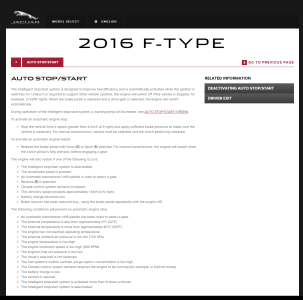

I wouldn't worry about stop start in this cold weather. It will not operate below 0C or when cabin temperature has not been reached, excessive drain on battery from heated seats etc etc. Check it again when outside temp improves.
@ajac
The following conditions will prevent an automatic engine stop:
An automatic transmission shift paddle has been used to select a gear.
The external temperature is less than approximately 0°C (32°F).
The external temperature is more than approximately 40°C (104°F).
The engine has not reached operating temperature.
The external ambient air pressure is too low (720 hPa).
The engine temperature is too high.
The engine revolution speed is too high (900 RPM).
The engine's fuel rail pressure is too low.
The driver’s seat belt is not fastened.
The fuel system's carbon canister, purge vapour concentration is too high.
The Climate control system demand requires the engine to be running (for example, in Defrost mode).
The battery charge is low.
The bonnet is opened.
The Intelligent stop/start system is activated more than 6 times a minute.
The Intelligent stop/start system is deactivated.

As you’ve seen from the information I posted, the auto stop/start won’t function if the external temperature is less than approximately 0°C and not 5°C as you originally stated.
Also if the Climate control system demand requires the engine to be running (for example, in Defrost mode).
The auto stop/start is functioning as it should on my car so a good overnight trickle charge on the battery should sort things out for member ajac.
