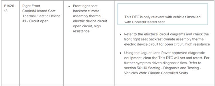

I have scanned the car with Topdon and get the following code error.
HVAC (HVAC Control Module)
B1426-13
Front Right - Climate Seat - Thermal Electric Device 1 - Open Circuit
Confirmed
When I have the scan tool attached, and clear the DTC's, with driver seat heating requested, the fan will kick in for a few seconds and then stop, so I think everything is working correctly with the exception of the seat backrest heating function, and as the error code suggests open circuit, I guess there’s a bone-fide failure there.
