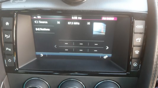

A couple of times recently I've jumped into the car and found that all the preset radio stations have been lost or forgotten. This applies to both FM & DAB presets.
The car is in regular use. The battery seems fine as Auto Start/Stop works ok, usually the first sign that the battery charge has dropped a bit.
Any suggestions anyone?

Have you touched the arrow on the screen (to the right of the 6 blank presets) which will show the next 6 presets. They might be there, if the stations were saved on this "next page", and when ignition is turned back on it might default to the "first page", which shows nothing saved. Just a guess.

If only it was that simple! No, they've all disappeared. :(
I used to have that on DAB+ sometimes on my XE with the same Infotainment system, but it would come back again after a restart - does yours come back at all or is it completely lost?
The only time, in nearly 4 years of ownership, that I lost all preset stations is when I pressed the "refresh" icon (just to find out what it did). It did find and store extra stations to choose from, but the process wiped away all of my preset stations, so i had to reset them all. Once reset they all stayed set. You could try pressing "refresh" and then reset your chosen stations and see if they then remain. Just for reference, I have disconnected the battery for 30 minutes ( for dreaded battery drain problem, after service) and when reconnected all my preset radio stations were still there.

This also happened on mine a while ago and was simple to resolve.
Looking at your pic (attached), all I did was touch ‘Source’ then ‘DAB’ and the DAB preset radio stations reappeared. You should be able to do the same for FM preset stations.
