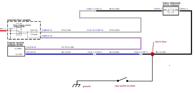

You have to short a wire to ground to force the valves to close all the time, I don't know but if you driving at at full thottle the back pressure might get a bit higher than normal, will affect performance I would expect?

I might stick an line switch in as per suggestion above (under the boot floor) just to have the option if it did become an issue on the day. Would help with the early morning cold starts too…
