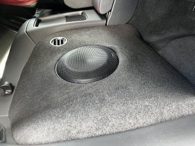

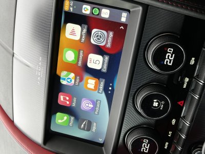

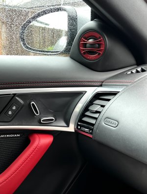

For anyone who is interested in replacing the entire system, do it!!! I have just had mine replaced with a Audison Thesis and Herts Mile Legend system. The whole interior has been soundproofed with custom tweeter pods plus two subs behind the seats with Thesis 6.5 Sax in factory door positions, but overall I was trying to keep a understated/stock look. The whole process of the build was on YouTube. The sound is now amazing using Tidal streaming Master uncompressed quality through Apple Car Play. If anybody wants to watch links below:

The car was with the installers for about a month. Audison Thesis range of speakers is one of the best out there and has been fitted in many top cars (Shmee150’s Mercedes SLS Black and loads of Lambos) but does come at a cost! Plus the addition of 50 sheets of Skinz 3mm soundproofing, amps, processor and the whole system being time aligned via Bit Tune software and then tweaked by ear to give the best sound possible in such a small cabin. There is also a DRC controller in the armrest pocket which allows you to have preset sound levels for when the roof is up or down. The whole system was around £12k but if you like music on longer trips as well as the sound of a V8 I think it is worth it.
