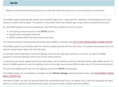

Looking at the manual it seems a few things can cancel it.
The lights have to be in AUTO and for the dipped beam to be active for it to work in the first place.
