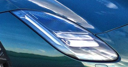

You can easily tell by just looking at the lights. If they are round inside it's the xenons and if they have flat rectangular elements and it says something like Jaguar LED Technology at the top inside the lights it's the LEDs. This is what my LEDs look like.

Thans, the lights say LED on the case. My confusion is when I enter the reg or vehicle type into say halfords or any other website and it offers me d1s bulbs?! Is there a way to upgrade the LEDS?
Crappy data somewhere obviously then. I haven't heard of any way to upgrade the LEDs, other than adjusting them up like you did.
