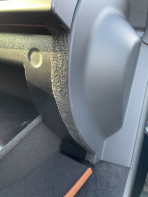

I've occasionally had a slight interior creak somewhere around the front of the passenger door. After some prodding in that area it turned out that the leather on the outer edge of the glove compartment door seemed to creak against the plastic underneath a bit if pushed.
Added some felt tape in the location shown (this is a LHD car) and fingers crossed haven't heard that creak since. Something to try out if anyone else has the same issue.
