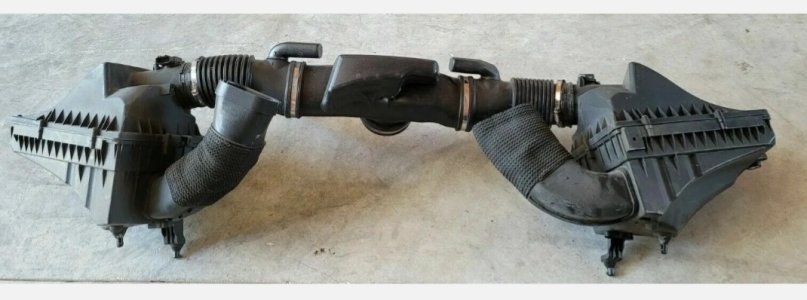

LOL AGAIN NOTHING LIKE THE F TYPE OR PROJECT 8 IM JUST GOING TO PUT A PICTURE UP AND U CAN COME UP WITH YOUR OWN THEROY. ITS HARD TO EXPLAIN THINGS TO SOMEONE LIKE YOU THAT DOSENT UNDERSTANDS MY SYSTEM THE WAY IT WORKS FOR ME . IT JUST TAKE SOME COMMON SENSE
Repost the picture you deleted so I can compare the two.
You haven't explained anything about your system after I asked some pretty straightforward questions, you have just re-quoted my post.
