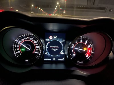

Hi,
Yesterday while I was returning home on the highway the amber engine light came on. Light is fixed and no engine power loss.
Last summer the same thing happened but then the amber light went out by itself after few days.
Last friday I went to the dealership to change the headlights and the dealer connected official diagnosis to code new headlights. During process he tell me if i had modified engine software ecu because diagnosis reported a different software from original. However dealer deleted all previous error including this summer error.
I have not modified the engine control unit but I do not know if the previous owner has modified it, even if he told me no.
Today i called dealer and he tell me to try to start car and stop it for 5 times. In this way amber light it should disappear but I haven't tried yet.
I read online that it could be a lambda probe, is it possible? how could i do to verify?
My car is a 2.0L P300 with 25000 km and 3 year of life.
Some advice?

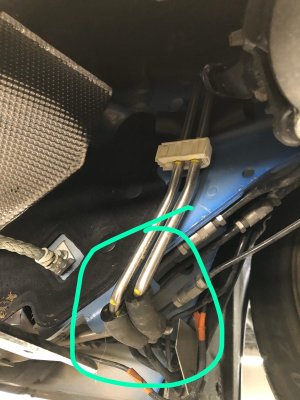

Have a look at this link on the 2.0L P300 (‘Mystery rattle noise solved’). I've also attached the photo from it....
https://www.ftypeforums.co.uk/viewtopic.php?f=27&t=3963
Taken from the link.....
Dan_Veluwe said:
I don't know if the construction with other F-Type's is alike, but in the P300 this can be the reason for an annoying
rattle you can hear around 1400rpm. We mostly heared it around 60kmph [ no wind or tyre noises].
It sounds like a faint version of the "rattle" used to scare birds from an orchard..
The source were [ not confirmed ] two brake lines near the exhaust and the petrol tank, touching the frame...
Could just as well be next to the point where the earthlead from the battery is fixed to the body.
Maybe someone who spend time underneath the car can verify the exact location...
In the circle the mechanic placed the black rubber pieces to prevent the rattle.
Dan_Veluwe said:
Next to earth lead, behind axle, LH side. Two fuel lines..
Idle vibration is the bearing of the translation actuator of the wastegate.. .. nothing more as far as I know. Let them check your fuel lines,
maybe that solves it...
If that's not the cause of the problem, you need to thoroughly check the exterior exhaust components and heat shields to ensure nothing is loose or vibrating. If it isn’t, the rattling may be coming from inside the exhaust and could be a worn/faulty baffle or exhaust valve? This link ('Exhaust rattle at low RPM') includes a video of what the owner says 'turned out to be a loose baffle' inside his F-Type R exhaust.....https://www.jaguarforums.com/forum/f-type-x152-72/exhaust-rattle-low-rpm-184078/ Also included in the link...."Not sure if its just a stone caught in the heat shield or something."
