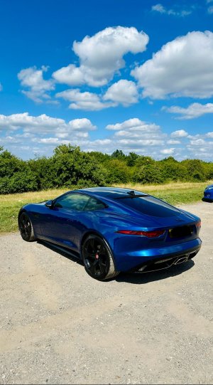

Thanks all for your tips - much appreciated! @Whoknows here’s a picture of her first “off road” adventure!

Congrats and welcome to the club! That is one cracking looking car! I didn't know it was possible to get an F-Type without keyless entry but that's surely just a good thing in London.
