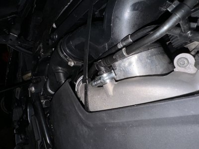

Yesterday, the pipe from the header tank to the new style aluminium component, came off during driving, leading to coolant going absolutely everywhere. Luckily I was in a position to stop and turn off the car quickly.
Looking at the spigot of the aluminium section it looks very rounded, which the plastic clip has slipped off, or maybe failed in some other way. It can now be pushed in and pulled out without much force or any releasing of the clip.

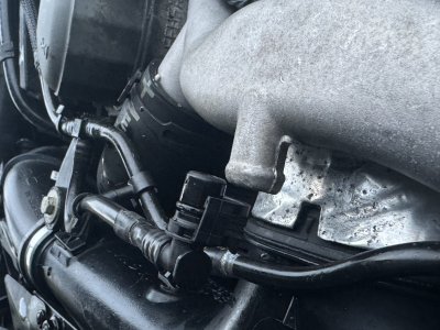

The older plastic style seems to have a much more square (flat) face, for this clip to click behind. (attached pic taken from another post I found whilst searching for information). 79E7BD04-8E7C-4DA5-B71B-986FF8D87ED6.jpeg

Currently held in place with a cable tie, so I could get to the tap to rinse off the coolant :roll:
Looking at the aluminium bit , I would use a fine file to remove the casting line on the side first and see if it holds on better . If that fails if you look at the alloy one versus the plastic one .The alloy one is rounded whereas the plastic one has a flat edge for the clip to hold on to. Depending how far the pipe pushes on , I would look at filing the rounded edge to look more like the plastic one but only if removing the casting line does not work.
thanks for the reply, this is one avenue I had thought about. I was a bit worried about taking too much material off and causing other issues, and was also wondering if maybe the pipe was meant to be replaced with a different type of fitment when the upgrade was carried out. It certainly doesn’t feel like a positive attachment
Once you’ve cleaned up the casting you could put a jubilee clip or similar around the casting and the locking plastic piece to prevent it flexing and popping off again. No need to be very tight, but just to prevent movement.

That is a very poorly finished casting and not at all suitable for that type of retaining clip. As already stated, I would file away the casting line and gently remove a little material so that there is a flatter surface just where the clip fastener sits. Once you are comfortable that it seats well, just a cable tie should lock it.
As discussed, I have cleaned up the casting and filed to create a flatter lip. The clip still does not hold, and pulls off very easily. Not sure how it held before to be honest. :?
Secured with a jubilee clip for the moment, but I am not happy with it due to the angles and pressure. So will have to look for a solution.
