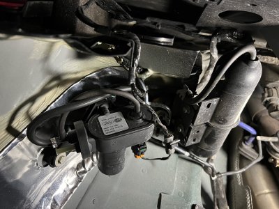

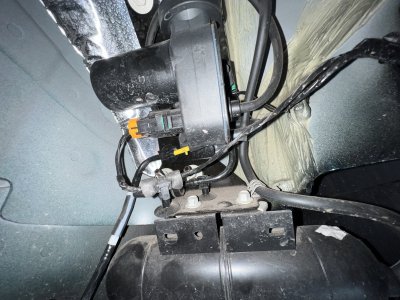

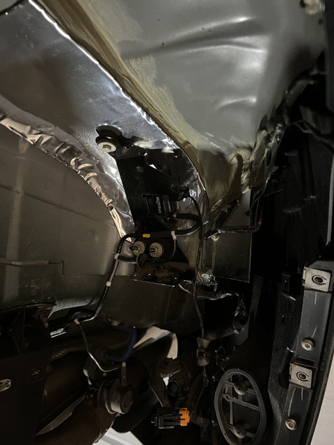

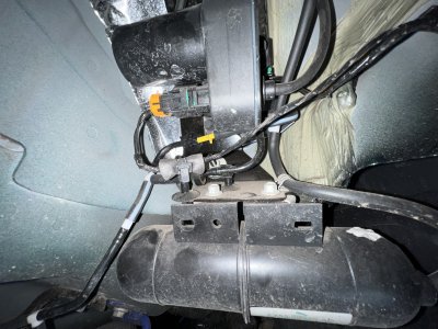

My ftype R from 2014 has exhaust flaps always open. I have searched the forums (and others) extensively but I dont find a match with mine, heres what I have:
-Flaps always open
-Lubricated them, all good, can open them by hand, no problem.
-checked fuse 15 and 43
-opened up the wheel well and made some pics. All vacuum lines seem connected, nothing hanging loose.
Heres where I get stuck. Dont know how to check the function of the vacuum pump and the ecm (if it gives a signal at all…)
Is there a tool to read/check the ecm?
Its good that the valves are open, but I’d like them to function as supposed
Thanks for any help
