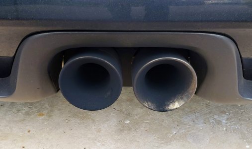

20190430_171908.jpgI have just posted a picture on another thread title "Is this normal" and now seen this one. So I am attaching the photo here as well and asking if anyone knows whether or not this is a problem. My car is 2 years old and has done 7,700 miles.
Can't imagine stuck/corroded exhaust valves causing that. Looks as though its running a very rich fuel mixture. What is the consumption like.

That mpg seems ok, but cant see how exhaust flap could cause it. After all when they are closed, they block off the secondary pipe so exhaust goes in one direction ie quiet & when open the gas goes in 2 directions ie noisy. Have you looked at the O2 sensor which could cause it running rich
Just a thought. Get a diagnostic done to identify the problem rather than trying a few different suggestions which it may or not be.

As your car is only 2 years old it will not have had a MOT. The O2 sensor is checked by the emissions check during an MOT. Nip in to your local Mot garage & ask for emissions check
