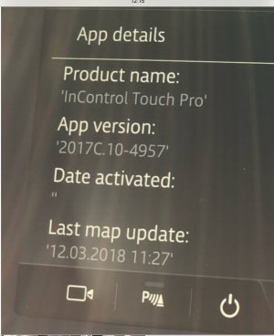

If you have the ICTPro (touch buttons along the bottom of the manin screen) then finding the software version should (note I say should) be the same as on the XE and F-Pace.
Open the nav up and get the map on the screen.
Press the "settings" button (cogs).
Scroll down to the bottom of the screen until you see "about".
Tap on that and it should take you to the "app version".
Interpreting the actual numbers is another matter but there is long running thread on the F-Pace forums (100+ pages) which might help.
This is the version I have. Just notice there is no activation date which may be why my license says expired.

As per your guidance, I have:
App version 2017C.10-4957
I think that's where the problem lies.
It should have been activated on pick up from the dealer.
That date is usually the date of first reg.
You are welcome.
The 2017C is the latest update so it looks like you are up-to-date.
It's also the update that's causing agg updating vehicles with a previous version (most noticeably on the F-Pace forums :roll: ) as it seems it has to be loaded in set stages and some dealers are cocking it up.
