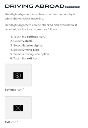

The F-Pace with Pixel headlights has this in the manual.
Might be worth checking.
Odd it is in F-Pace manual but not the F-Type.
But glad it's sorted.
The information is in the online manual under Adaptive Driving Beam (ADB) instructions. It should set itself based on where the Satnav detects the car's location.
