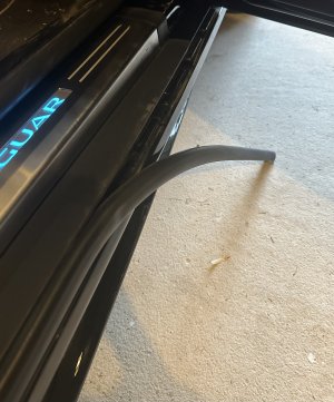

Hi has anyone experienced the same problem with the drivers rubber door seal coming loose?
Looks like the small white pegs which are supposed to hold the seal in are missing/snapped off.
Has anyone used any sealant or glue to hold the seal back in?
Or can you purchase replacement pegs from Jag?
Thanks in advance
Search for Jaguar F type door seal clips on eBay. Usually someone has been not too careful when removing the seal and torn the rubber slots that the T pieces go into. It looks like you can get a new seal from interweb between £30 and £60.

Just use number plate tape if not using new clips.
