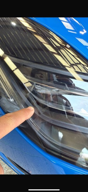

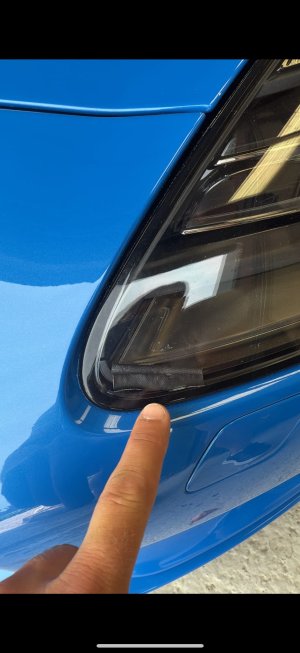

I went to look at a 2019 F-type yesterday and while there forgot to look at the lights. I had a look on the pics and video and the passenger side light seemed to be dimmer . I called the dealer who said it was some wiring that had slipped in front of the LED's as in the photos. Id not heard of this happening and only heard of the DLR failing. Has anyone had this happen to them. I'm happy to purchase if this is sorted.

Yes, had exactly that, It's from the protective cover on the wiring, dealer removed it for me under warranty.
Another user had same
https://www.ftypeforums.co.uk/viewtopic.php?t=8626

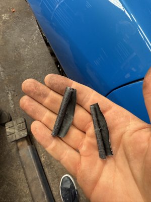

It definitely has the DRL problem, I'm absolutely gutted as had fallen in love with this car. He had removed the sheafing as well.
