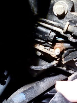

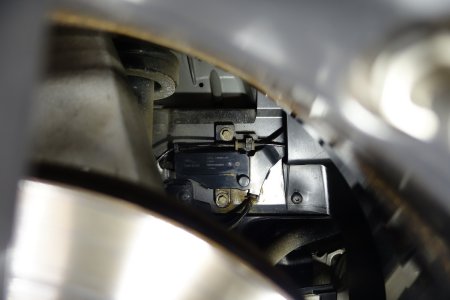

Geoff, Have you checked the Battery cable chassis point in the drivers front wheel well, it's prone to corrosion.
This is mine in the plastic box at only a few 1000 miles!
