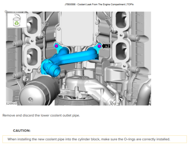

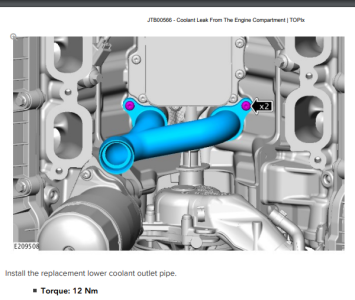

The document in this link https://www.ftypeforums.co.uk/viewtopic.php?p=62058#p62058 shows the original lower coolant outlet pipe (Y pipe) and the replacement pipe. Remove engine top cover for access. You can see the difference between the two in these screenshots.....

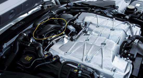

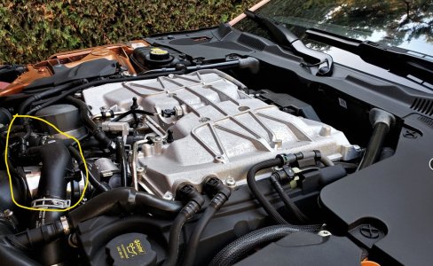

Ah, the pipe I referred to in my post wasn't actually that lower Y pipe but the upper part that goes on top of it and also comes in a new revision. IIRC it's replaced when the Y pipe is replaced and is probably the most easily spotted sign of a new Y pipe.
Old version:
New version:
I had both these parts replaced in my last car.
To confirm, my car has the original upper part as shown in your 1st pic.
Yes, this makes it easier for the OP to check by visual inspection. However, being as this is going to be done, it's worth checking the neck of the 'Y' pipe as explained earlier.

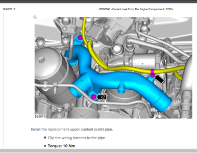

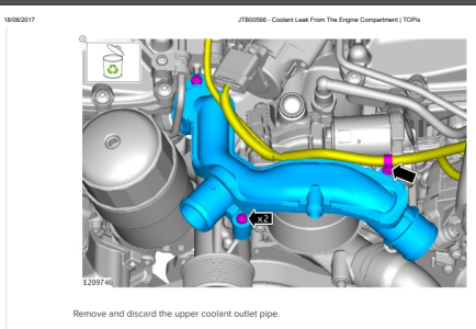

I’ve attached two further screenshots from TOPIx which show the upper coolant outlet pipe. The first one is the original version and the second is the replacement (modified) version.....this will also help anyone distinguish between the two of them when checking if the replacement lower coolant outlet 'Y' pipe has been installed.
