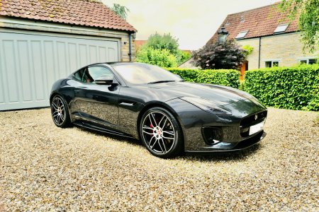

One year on since the Cat was detailed it's still looking good. The coating is Gtechniq Crystal Serum Light topped with EXO. Only treatment since is washing with Gtechniq W4 Citrus Snow Foam and then the two bucket job with Gtechniq G-Wash and the G6 Perfect Glass Cleaner to finish, all of which is pretty effortless. One trick I'm now using is to dry the car in almost one go with a number of large microfibre towels quickly laid over the horizontal panels. Stops premature drying in warm conditions and reduces the chance of swirls as the towels are just lifted off.P300.jpg
when you lay the microfibres over do you need to rub to dry or just leave them to soak up the water?
They absorb 95% of the water almost immediately. What little remains is picked up by straight strokes with a hand towel after removal. Generally by the time I’ve finishing laying the towels on the car the first ones are ready to pull off. I use the XL towels from the Wipeshop. https://www.thewipeshop.co.uk/index.php?cPath=25 All their products are excellent value.
Looks beautiful. I've not tried that method of drying the car - usually I take mine for a 5 minute belt down the highway, you lose most of the water at 100kph, save around the back. Also a leaf blower works well to dry the car.

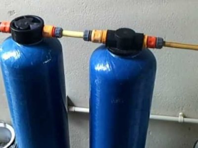

Alternatively give up drying altogether. Makes a real difference in hot weather
https://www.vyair.com/en/0817-high-pressure-reinforced-long-life-resin-vessel-11-0-litre-capacity-blue.html
Get the resin for hard water, as it does go off fairly quickly.
yep .. i use this for rinse
water is 0ppm so pure ... these are resin di vessels lasts me about a year to clean 3 cars and all my house windows
