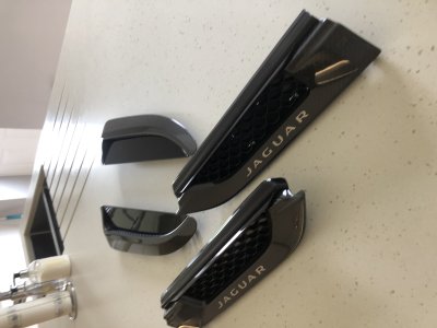

07E6AECB-EFC8-4726-8158-CA0174885D97.jpegHi fellow F-Typers.
Have treated myself to some carbon fibre bonnet and fender louvres from the Jaguar clearance sale.
Any tips or tricks or not what to do before I attempt to fit them?
Fitting instructions for the Fender ones seem a bit harsh as I am being asked to drill two holes in each one (chrome ones) to attach a cable tie with which to pull them off :o
Any advice gratefully received

From what I’ve read bonnet louvres are easy pressure clips. Side vents seems to have to be destroyed :?
This may help -
https://www.ftypeforums.co.uk/viewtopic.php?f=21&t=2005&p=19150&hilit=Side+vent#p19150
I changed my side vents by following previous posts on here. Removing the wing panel bolts does allow just enough room for fingers to get behind the clips,. No need to trash the old ones.
It's still a bit fiddly as I seem to remember one clip not wanting to let go. Just use masking tape to protect any surfaces and bolt heads, although I used touch up paint on the very corners of the bolts afterwards. And put a rag in the hole in the sill to stop the bolts dropping in there
Bonnet vents easy enough, just a little fiddly. I used little bits of old plastic credit cards to make sure the clips don’t pop back into place after you’ve released them , as there are more clips than I’ve got hands!

For what its worth, I fitted mine today. Bonnet louvres are easy they just clip out.
Side vents I followed the Jaguar instructions and drilled 2 holes each side and basically yanked them out. Had to revert to pliers when the cable tie snapped but it took 10 mins each side. A tad disconcerting taking a drill anywhere near the car though I must say!
@willowftype, sorry just seen this. I did fit mine but didn't go down the drilling route as it seemed a bit cruel. With the bonnet and door open I managed to get the cable tie behind the side vent and then pulled the vent out.
