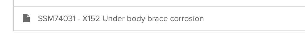

Spotted this whilst looking at Topix today.
Can anyone tell me what this campaign is all about? I've tried google but no joy..
Would be interested as I think I have this issue.
Seacourt.

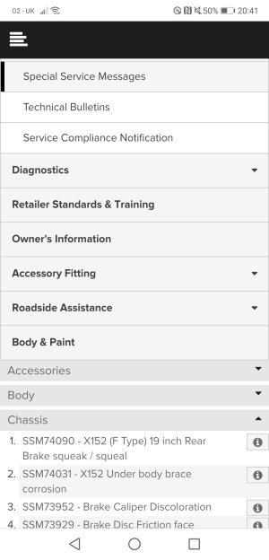

I am being told it appears the bulletin has been removed. They said it probably will be reissued at some point.
