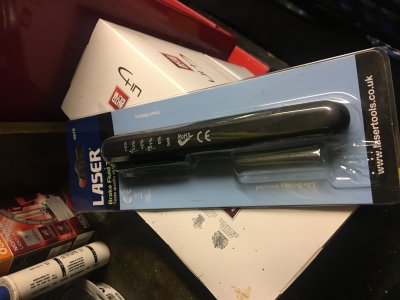

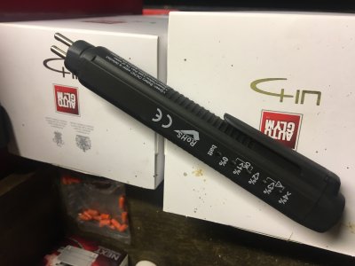

I will check mine before booking her in for this years service. Looking on Amazon, is it worth paying extra for the hand held flexi type tester over the cheaper hand held pen type, or does the later work just as well?
I went with the Laser pen type.
It’s well made and fine for the F, but if you have a few cars in the family it’s worth checking first as some reservoir caps (e.g. Suzuki) are tucked away a bit and could make it difficult to keep vertical when you dip your nib :shock:
