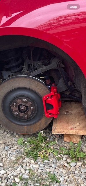

Don't doubt yourself.
All it takes is to remove a wheel, use a small wire brush to scrape off any loose paint/corrosion, spray with brake cleaner, apply new brake caliper paint. I only painted visible surfaces so didn't take much time at all.
Will it be as good as a good pro no, does doing it yourself provide really good results for less than £10 per caliper yes and you might just enjoy yourself. Worst case you can still use a pro!

Nice job. It’s that gloss look that pops I’m after 👍
