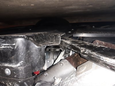

F Fez New member Apr 13, 2020 #1 Afternoon all, just wondered if anyone knows the size of the bolt that holds engine protection tray in place drivers side. You can see the weld nut in middle of picture where the bolt goes. Apologies that picture upside down. Regards Fez Attachments 20200413_120902.jpg 4.6 MB · Views: 1,308

Lunar New member Apr 13, 2020 #2 If you can find what spanner fits the weld nut that should tell you. IIRC... M6 is 10mm a/f. M8 13mm. M10 16mm. Or just try one lightly - my guess would be M8 mate

F Fez New member Apr 13, 2020 #3 Cheers Lunar, not sure why I did not think of that, a 10mm spanner fits the nut so now just need to find a M6 bolt now. Thanks
