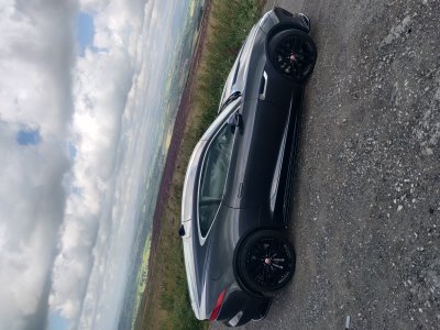

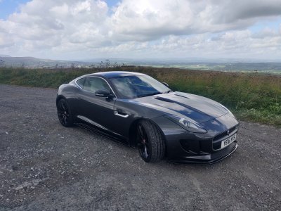

Looking for some help/advice.
I've currently got chrome on my side vents, window surrounds, front grill surrounds etc but think I may prefer the look of the 'black pack'.
I've been looking around at the easiest/best way to get it changed and saw an old post about somebody getting their chrome kit re-sprayed to black but wondered if there is another way or better way of doing this?
If anyone has done this in the past I'd appreciate any advice.
Left pictures below as would also be keen to hear whether you guys think black or chrome would look better.
Thanks!
Easiest and cheapest is to have all the chrome wrapped. Approx £250 and will last more than 5 years (don't know of anyone who's had this wrap past that age yet).
Sean at Xtreme Signs near Crawley has done this on quite a few F type's, including my V6 when I had it.
I've seen plastidip used too and couldn't tell. Both this and the wrap are easily removable l
I had a black f type convertible with the black pack and personally thought it was too much it needed a bit of couloir to show the lines off but it is each to their own cheers Tony.
I changed my side vents from chrome to black. Easy to do and took about 25 mins each side. Open the bonnet, remove rubber cover above vents one screw one Alan Key. Remove the 3 bolts above the vent and two from the door side . Open the door and the two bolts will be visible. Pull the wing forward and get your hands in the back and unclip the vent. Replace with the black one and put the bolts back in.

The all black thing has been done to death and I like seeing a bit of silver now (I have a P450 Plus and that's ALL black). I think I would go the other way and yes swap out the side vents to black but after that leave it and maybe even have the alloys refurbed in an alloy silver colour. You have the accents of silver on the alloys with the studs so maybe embrace the silver.
