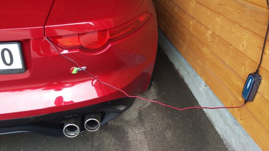

My Ctek plugs into the "fag" lighter socket on left hand side of the boot. Been there for 2 months now. Cable trapped by boot seal which is very soft, so no issues there
