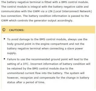

I found this in the repair manual. I assume any chassis earth will do for the negative connection of a charger, just not direct onto the battery negative.
I connect mine to the point where the negative battery cable is bolted to the chassis, under the boot cubby. Those instructions refer to connectng a slave power supply, which is apparently neccessary when updating software, not a charger.
