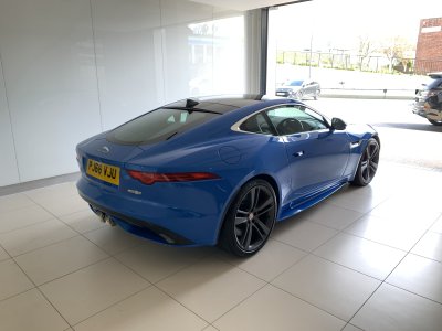

Honestly taken me years for this moment, but am now a very proud F-Type owner. Looking forward to learning a lot about the car and more importantly having some fun!

Welcome to the club! Lovely colour, that was the colour of the car I test drove but someone put a deposit on it while I was deciding whether I should buy it! But they're great in any colour, so I'm happy!
Oh, and get those grin muscles toned up!
What a beauty, she will give you miles and miles of smiles. It’s such a stand out, striking colour to.
Enjoy the neck ache looking back at her once you’ve parked :D
Congrats ! Used to have one like that, a humble P300 then. But my lower bumper lip wasn't as scruffy as this one.. :mrgreen:
