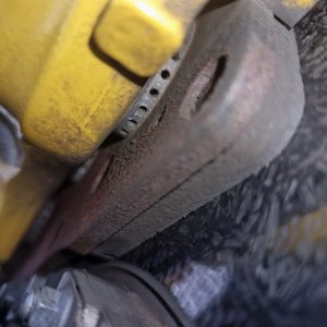

yes, we had the wheel off and the screen looks good.
I just haven't been on the brake caliper yet, so I'm always very careful.
Brake pads also look good, are still far away from the wear mark.
Vehicle has 40,000 miles.
Should I clean it with brake cleaner?
