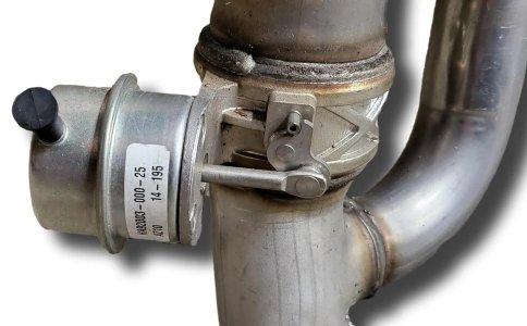

Are you sure the spindle is broken? It would be unusual for it to sheer off and both the lever arm and flap remaining in place without something falling out.
Have you checked if the lever arm/cam is rotating on the shaft? If so a simple spot weld could fix it.

Also sometimes the spotwelds on the actuator can come loose, so although it operates correctly it just pushes the can away from the exhaust. A couple of tie wraps at 90 degrees to each other sorts it 👍

Thanks for your input. The spindle slipping on the cam was a good thought but I have just had a more thorough check and yes…..the spindle is snapped….bummer!
