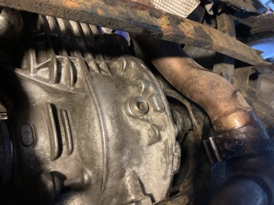

I gave the breather a good rasp clear with a cut down cable tie, and got the fluid changed, no significant problems and it was a nice mild day to be in the carport working on the car, with some tunes blasting out, instead of the actual day job!

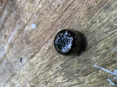

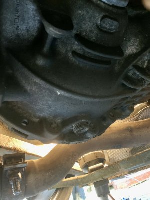

As can be seen in photos, the old fluid was predictably black and plenty of gunk on the drain plug magnet. You can see how grimy the base of the diff was! This was 25k (in 5 years) since it was last changed. The level was definitely down a bit from the spec 0.86 litres so I’m glad I didn’t delay this task any further. It’s reassuring knowing there is lovely clean Castro BOT720 in the diff again and I saved a wad doing it myself!
