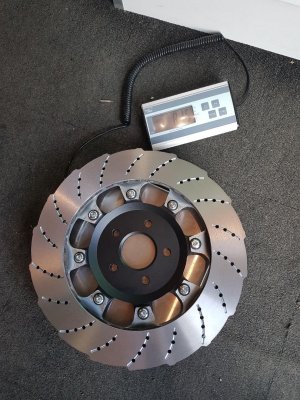

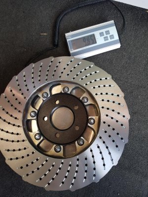

OK so does not seem much interest from people here, but the disc are been test fitted to my car next week.
Total weight savings are 21kg (46lbs) which matches the savings of ceramics with nowhere near the cost. :)
The following images are of the F-type disc with original disc weights VS new 2PC floating disc weights:
SUNCUT Edge designed rotor:
PLAIN Edge designed rotor (weighs few grams more but traditional style):
Price is around £1850 for a full set, if interested drop Wortec an email at [email protected]

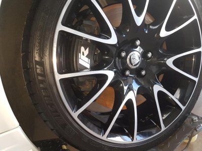

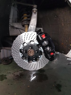

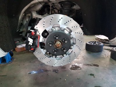

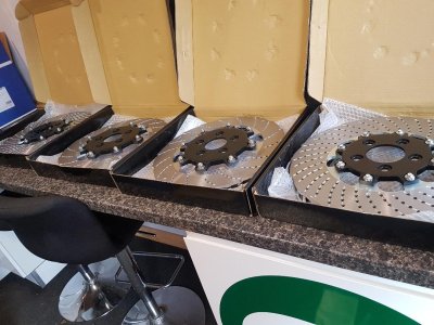

I just joined to post on this thread as am having my Wortec suncut's fitted to my XK Dynamic R today.
I'm going for stock calipers and EBC red (since my track days and airfield runs are long behind me)
Hope no one will mind me posting but wanted to get the latest and ask some questions.
1) Anything to be mindful of immediately after fitting (apart from the obvious bedding in period)?
2) After 6+ months of driving any updates to report back?
3) What is corrosion like? I live less than a mile from salt water and everything tends to rust
4) Any regrets?
My 2014 car's fitted with (I believe) the same super performance brakes as on the F-type, running 20" vortex alloys shod with MPS4S's
As I believe mine will be the first set being fitted to an XK they are using my car (like Gibbo's) for promotional work. Appreciate there are many more XK's out there in comparison to F-Types, so potentially opening up a new supply stream.
As you can see from the pics the weight of mine will be a combined 36kg/ 81lbs will be retaining my old discs and pads so will be weighing these and posting up my weight saving.
Once again I hope you'll not mind me joining, I was torn between a F and an XK but sadly the F didn't have the luggage space required for trips away in the UK and Europe.
